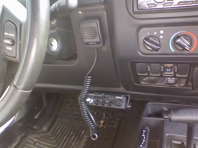

Then installed a CB-radio in the foot-well of the front-passenger-side. Also installed a switch so that I can choose when my interior lights come on ...

And, a simple install of the CB-Radio on the bottom edge of the dash. Seems to do well enough there. Yes, the seat does touch the CB when I move the seat forward to put people in the rear, but, it isn't putting alot of pressure onto the CB so I am not too worried about it. I still need to figure out a good place to clip the microphone. So far, I haven't picked a spot, so, when I am not using the system, the mic sits in my glove-box.
I've got the 520xl in that same spot. I have my mic right next to the steering wheel. The bracket is held on with one of the screws that holds the dash piece on. No drilling, perfect location, and the mic cord doesn't get in the way of anything.
Put mine in a similar spot on the other side. I'm 6'3 and it doesn't interfere with anything at all. I recently took the mic mount off (because the mount only had 1 screw and kept moving) and just wrapped it around the wiper control stalk.
EDIT: Just stole your idea and put my mic mount where you did, but I added an extra screw on the left side for more support, Nice and tight now.

BTW: I thought about putting my CB where you did 2006Sport, but, that is where my digital electronic brake controller sits for my 7-pole wiring harness to my trailer. I am also trying to find a location for my 12-volt to USB plug ... haven't found the right place for it to call home on my dash - yet.
