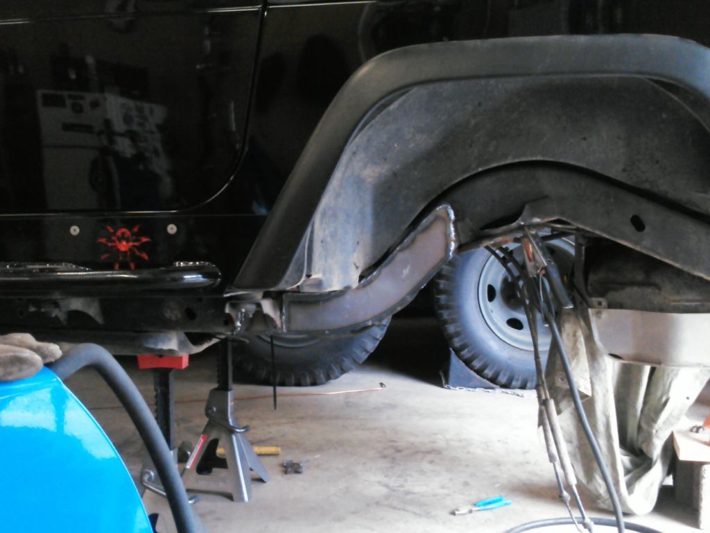

Get the safe T caps , remove the cross member and cut out or grind the rust, spray inside the frame Eastwood's frame inhibitor, position the safe T cap and clamp. Call a professional mobile welding service that has "liability insurance" to come to your house to weld the safe T cap in place. The welders hourly charge is around $60 and I'm sure he or she will not be welding more than three hours. Buy 2 cans of undercoating or some por 15 and call it a day! This job is complete and done properly for under $1000.

I found my passenger frame rail rotting out between the control arms right after I bought my tj. There is a local 4X4 shop here in Hickory NC. They helped me source a passenger frame rail from a junk yard in good condition. You can used a damaged frame as long as the side you want is good. I paid $125 for the frame rail and $600 for the 4X4 shop to replace the rotted section. Very pleased and looks as good as new.
I could have gotten a used undamaged frame for $400-$500, but the labor to do the swap would have been alot. 4X4 shop said it should be fine with just the passenger section replaced as the rest of the frame, tub, etc was very clean.
The 4X4 shop guy said it is common on northeastern jeeps where there is alot of snow and/or jeep is on the coast. He said the passenger side was the most common because the salty water collects on the side of the road and the passenger side is getting more exposure.
