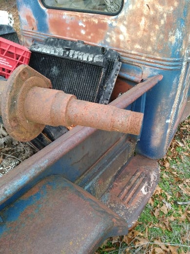

What say y'all? I'm looking for opinions, tips, what would you do's... etc...
I've got a rear D60 out of a 75 IH truck. It's been sitting out for a good ten yrs... with exposed spindles... are these salvageable?
I thought to soak them in some naval jelly or evaporust for a good bit and see what happens.

I think they are worth cleaning up.
Remove the rust with a chemical or blaster.
Lightly smooth with emery cloth.
Insure the seal area is smooth, as the bearings run gear oil. I think this is the area you need to worry about the most.
Test fit the bearings. They should be a slip fit. If they are slightly sloppy, you can peen the race area.
Don't forget to run a chaser on the threads.

I think I would try sand blasting then polish with a super fine sand paper like 1000 or 1500 grit so it’s seals will still work

Yeah I may as well try before condemning them right. Be a good use to try out my "pipe polisher" too.

Update... pulled the carrier and pinion. Bearings show overheating signs...
And this is what a 36 hr soak in evaporust did!
A 3.5 gal bucket of that poured into a 5 gal bucket is a perfect setup to soak FF ends in.
