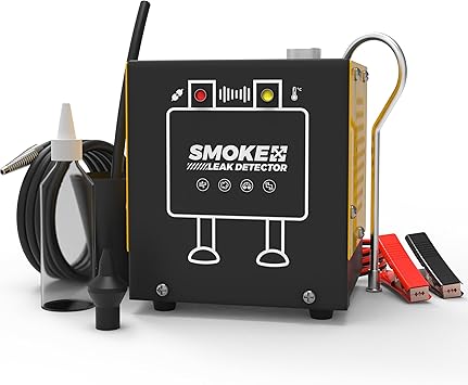

Else el-cheap-o smoke machines for leak detection can be had starting around $50. Even the cheapest of the cheap still work pretty well and will find most leaks
