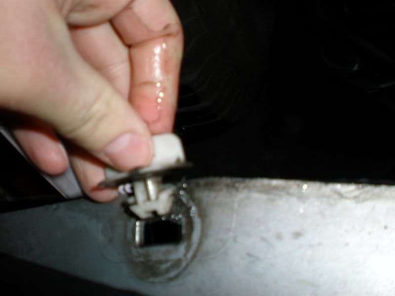

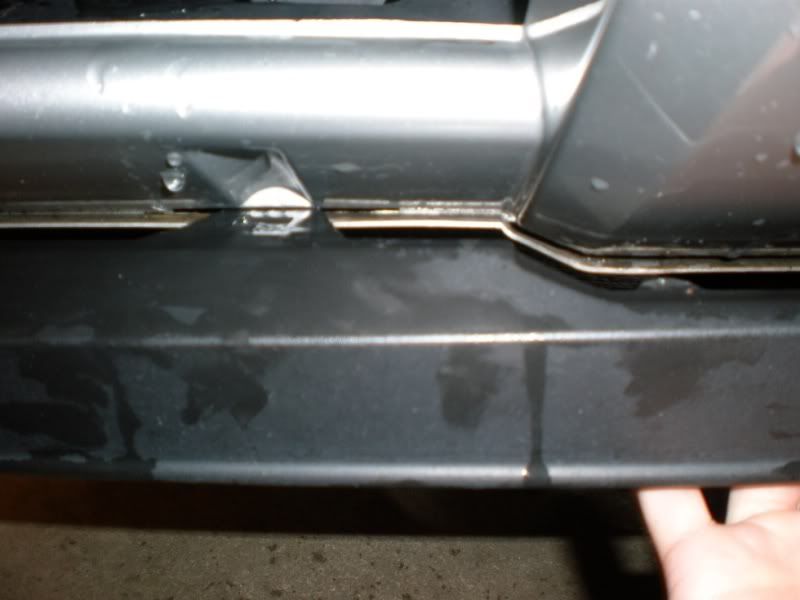

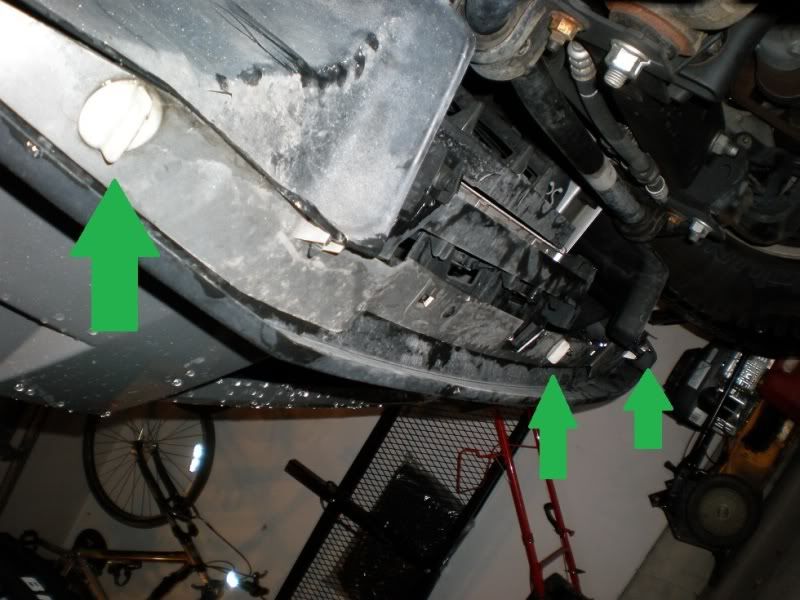

First locate the plastic clips that look like this:
There are three of them: *edit* see bloodyshadow's posts for details, some 2008 models may have a fourth plug

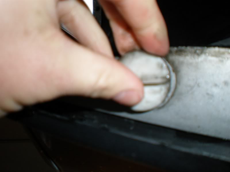

Give each one a quarter turn and they pull straight down:

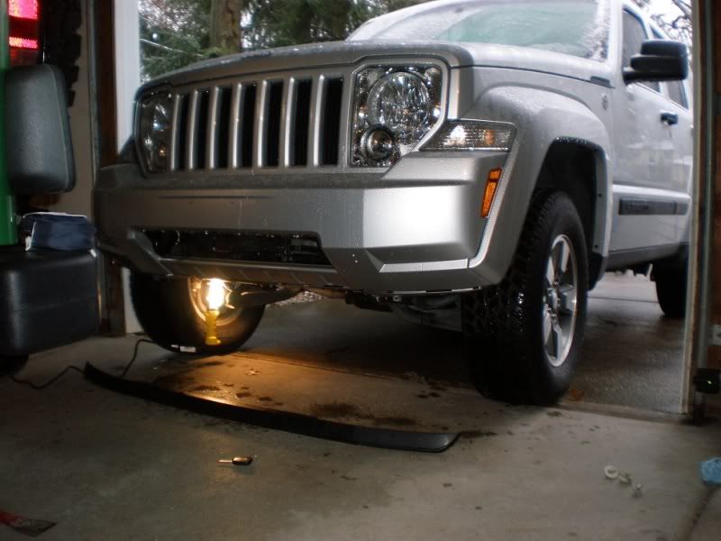

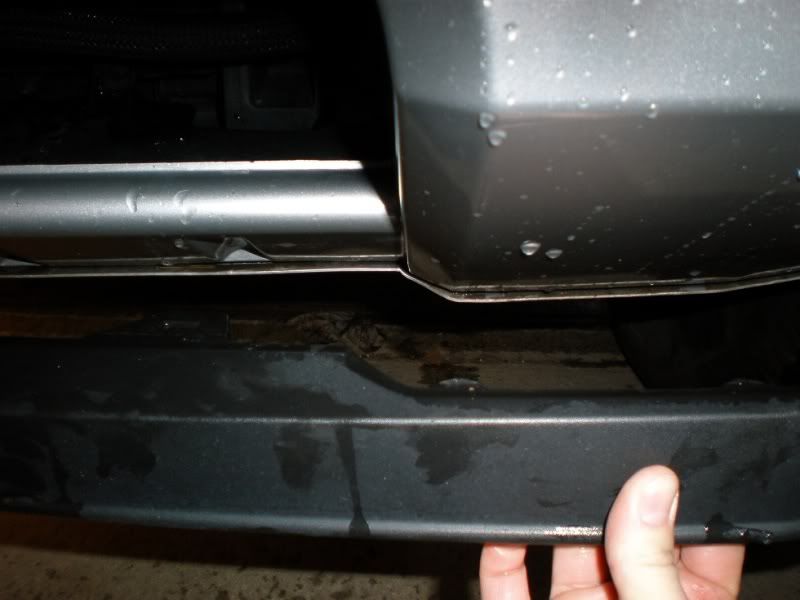

once all three are out, pull forward on the air dam:
Now you are done!

Do not remove any screws or rivets. Those screws are holding the fender liner to the bumper. If you remove them it will flap around loose at the bottom. The only thing that you need to remove if you want to take off the air dam is the three plastic plugs as I have shown in the pictures.
I tried exactly what you said and it's moving with the entire front fender. Like its all one piece. I have no idea what I'm doing wrong XD
#10 ·
I had a similar experience. It might take a little force, but as long as all three plugs are out it should come off. I figured it was tougher on mine because of ice, but it could also be snug due to 3-4 years of driving and being jammed in there by air pressure and dirt stuck in the groove.
